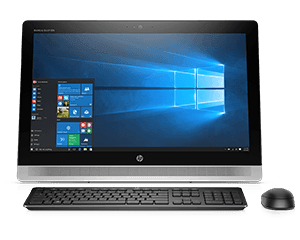

HP EliteOne All-in-One Business PCs
Enterprise-class space-saving performers that are as reliable as they are stylish
